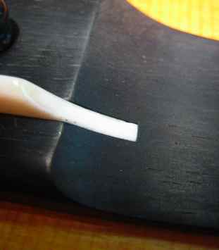

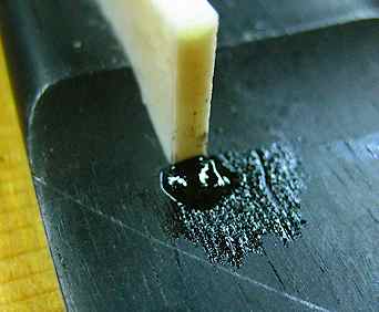

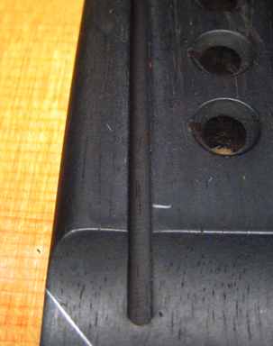

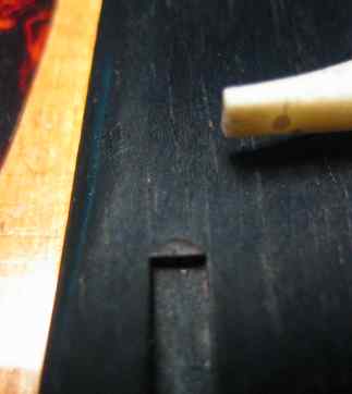

Here are some shots of a drop in through saddle I did for a saddle
transducer installation. The ends match the style that Martin is currently
using, and offer a pretty clean look.
I filled the ends with a black tinted epoxy on an ebony bridge here as
Martin does, though it would not be much more work to chisel the ends
square.
PostPosted: Thu Nov 01, 2007 6:16 am
Posts: 2060
PostPosted: Thu Nov 01, 2007 10:21 am
Posts: 460
David,
I do mine in a similar fashion. The difference is I square off the slot before cutting the saddle to length, so I don't have to fill the ends. Of course, this is on new work where I'm not trying to save an existing saddle.
Jimmy Caldwell
